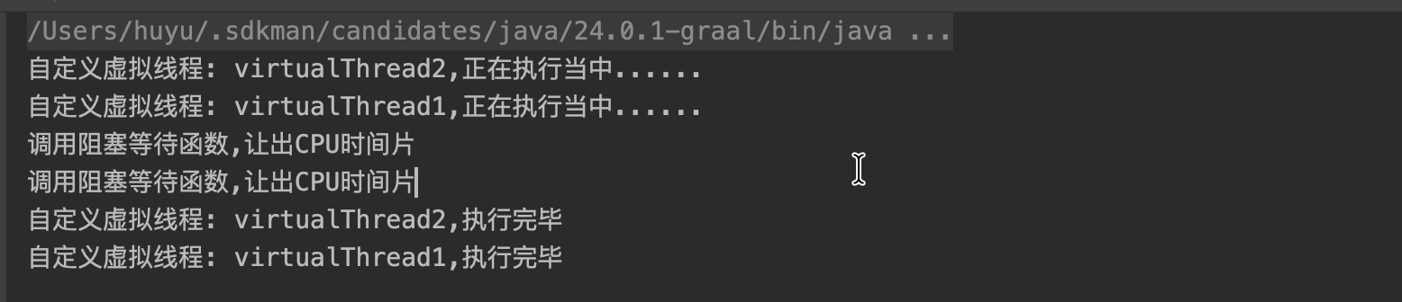

1. 简单测试代码
package com.huyu.thread;
public class SimpleCreateVirtualDemo2 {
  public static void main(String[] args) {
    VirtualThread virtualThread = new VirtualThread("virtualThread", () -> {
      System.out.println(
          "自定义虚拟线程: " + VirtualThread.currentThread().getName() + ",正在执行当中......");
      WaitOpt.await(1000L, true);
      System.out.println(
          "自定义虚拟线程: " + VirtualThread.currentThread().getName() + ",执行完毕");
    virtualThread.start();
    VirtualThread virtualThread1 = new VirtualThread("virtualThread", () -> {
      System.out.println(
      System.out.println(
    virtualThread1.start();
执行效果如下:

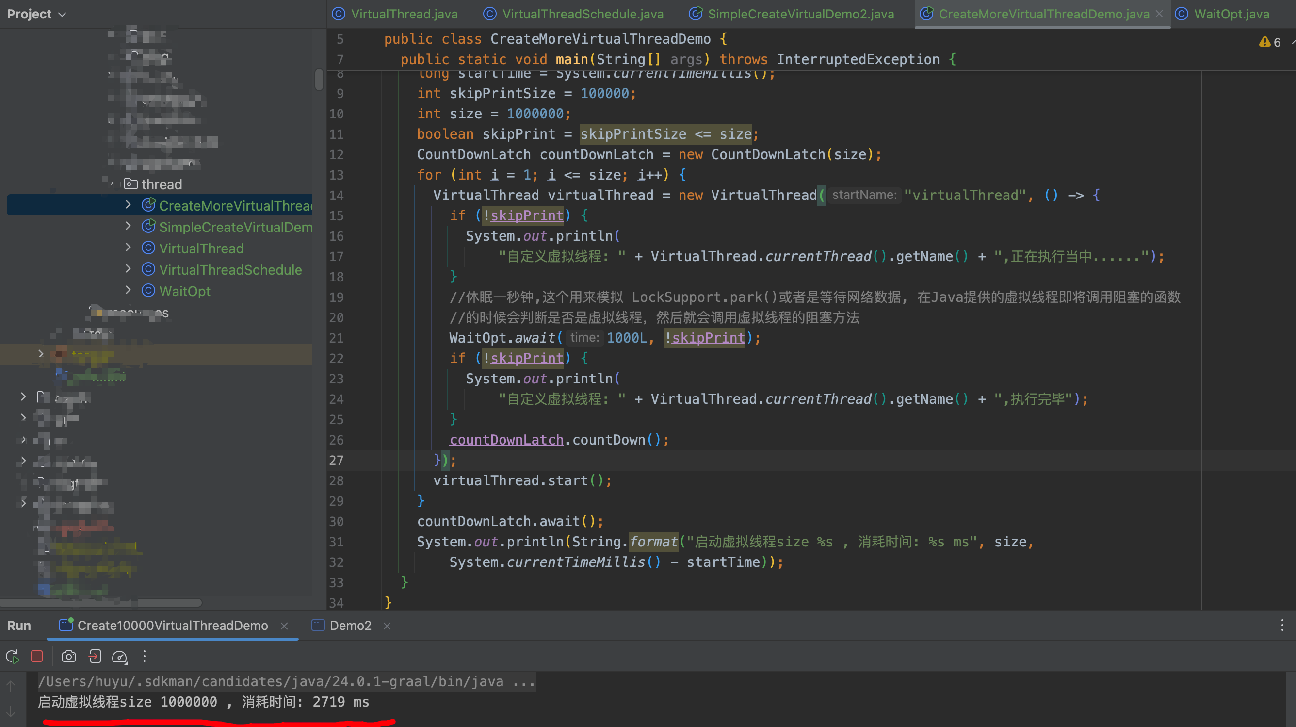

2. 复杂创建百万虚拟线程测试代码
import java.util.concurrent.CountDownLatch;
public class CreateMoreVirtualThreadDemo {
  public static void main(String[] args) throws InterruptedException {
    long startTime = System.currentTimeMillis();
    int skipPrintSize = 100000;
    int size = 1000000;
    boolean skipPrint = skipPrintSize <= size;
    CountDownLatch countDownLatch = new CountDownLatch(size);
    for (int i = 1; i <= size; i++) {
        if (!skipPrint) {
          System.out.println(
        //休眠一秒钟,这个用来模拟 LockSupport.park()或者是等待网络数据, 在Java提供的虚拟线程即将调用阻塞的函数
        //的时候会判断是否是虚拟线程,然后就会调用虚拟线程的阻塞方法
        WaitOpt.await(1000L, !skipPrint);
        if (!skipPrint) {
          System.out.println(
        countDownLatch.countDown();
    countDownLatch.await();
    System.out.println(String.format("启动虚拟线程size %s , 消耗时间: %s ms", size,
        System.currentTimeMillis() - startTime));
得出结论: 在Mac M2的机器上,执行100万虚拟线程需要2s时间,如图所示:
